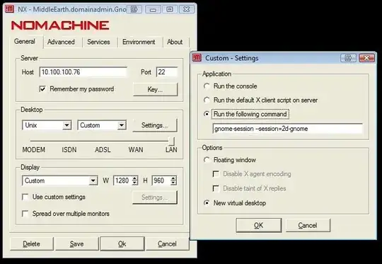

Example for nomachine's NXClient:
Under 'desktop'
select 'unix' in the first drop down menu.
select 'custom' in the second drop down menu
click 'settings' on the right of it.
choose 'Run the following command' and insert:
gnome-session --session=2d-gnome
-or-
gnome-session --session=classic-gnome
and choose the 'New virtual desktop' option.
NX Client Configuration dialogue
