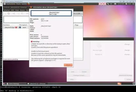

Screenshot: (as root) gparted fails to find fs info
Surprise Surprise! root's gui is broken too: gparted fails to get info, user&groups is entirely grayed out (this is a different behaviour than my regular user). Weirdly enough the Login screen administration proggy seems to work fine.
