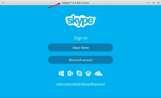

I upgraded to version 4.3.0.37 because version 4.2.0.13 was not allowing me to login anymore with the error “Can’t connect”.
Unfortunately for me after hours of trying I could not get pulseaudio to work on my system, only ALSA is working so I downgraded back to 4.2.0.13
To solve the login error I spoofed the version number 4.2.0.13 to the latest 4.3.0.37 version and login was working again, problem solved.
So to solve your problem simply downgrade back to 4.2.0.13 and spoof to 4.3.0.37 version, exit Skype and run this command:
sudo sed -i "s/\x34\x2E\x32\x2E\x30\x2E\x31\x33/\x34\x2E\x33\x2E\x30\x2E\x33\x37/g" /usr/bin/skype
After you should be able to login as normal.
