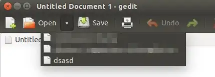

For example, my gedit shows 3 files:
If I search for gedit in the file, I can surely see 3 "stanzas" because there are 3 files, here's one of them as a sample:
