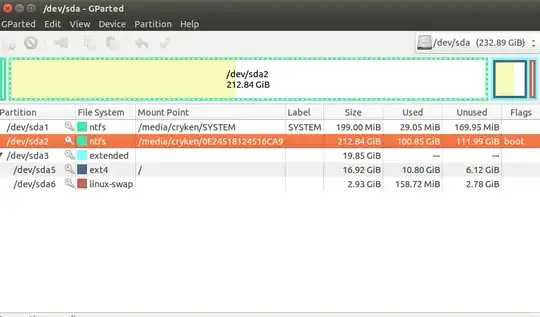

To give more space to Ubuntu, you'll need to do a few things:
  • Shrink /dev/sda2
  • Resize the extended partition (/dev/sda3) to include the space freed up by the previous step.
  • Decide whether the space is for system applications (those installed by apt-get, Software Centre, etc.) or user applications (those installed by you from source, precompiled binaries, etc.
  • If the former, resize root (/dev/sda5); if the latter, make a partition in the free space and mount it somewhere convenient. I'll cover the former for now, and the latter if anybody requests it.

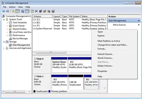

  • Shrink using the Disk Management section in Windows' Computer Management.
With GParted, you can shrink to free up as much space as available, but the operation will be slow. With Windows, shrinking will be very fast, but you may not be able to free up as much space as is shown to be unused. This is because the Windows utility only shrinks upto the last used sector, whereas GParted moves around files. I recommend that you see how much Windows is willing to free up, and if it is satisfactory, use it, or else use GParted. And if you do choose to use GParted, use a live CD/USB to do so. I'll assume a live environment for any Linux operations henceforth.
  1. To shrink in Windows, right click My Computer and select Manage. Go to the Disk Management section, select the C: partition, right click it and choose Shrink Volume: Random image lifted from the net
  2. To do so in GParted: Unmount the partition first if it is mounted (the key icon shows it is mounted) by right clicking /dev/sda2 and selecting Unmount. Choose Resize/Move, and drag the right end of the slider (or enter in values manually) until enough free space is shown at the end of the partition.

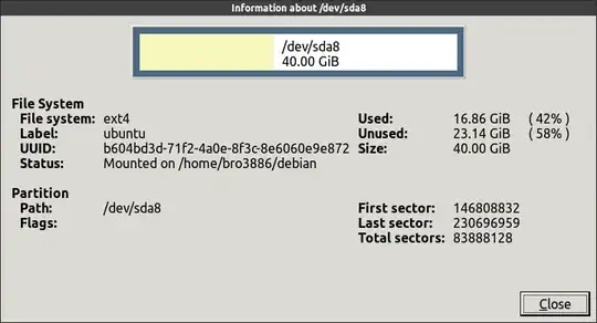

  3. Right click the root partition and select Information. You'll get a window that looks like this: GParted information window screenshot Copy the UUID to somewhere (open a file in gedit and paste it there, if you will).
