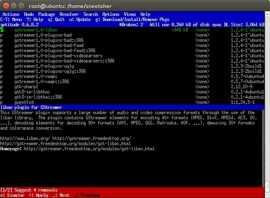

Instructions to resolve such case:
  1. Install aptitude:
    sudo apt-get install aptitude
  2. Run it:
    sudo aptitude
  3. Press / and search for gstreamer1.0-libav then Enter
    Check it is not gstreamer1.0-libav:i368, use n to search for next.
  4. Then press + to flag it for installation

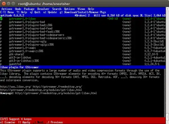

  5. In this case there two solutions, see red message at the bottom. Use . or , to choose Suggests 4 removals which is the one we are looking for.
    Aptitude: Suggests 4 keeps Aptitude: Suggests 4 removals

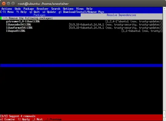

  6. To confirm that it the right solution, press e so it will examine and show what it going to do.
    Aptitude: Examine solution
  7. If it's OK, press ! to Apply that solution then g to start installation process.
