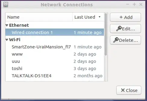

Lubuntu comes with Network-manager, which makes this very easy. Click on the network icon in your panel, and select Edit connections.

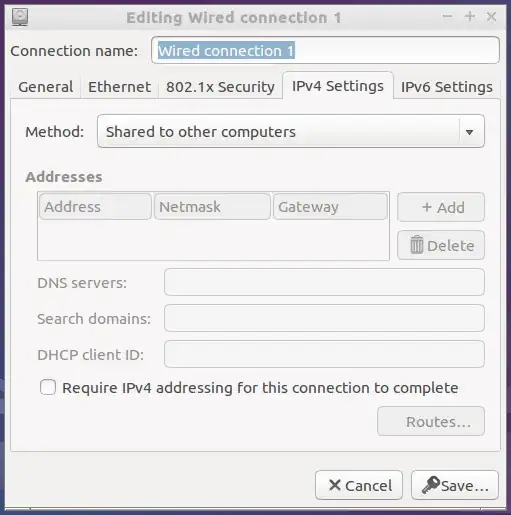

In the dialog that appears, select the wired interface and click Edit. In the IPv4-settings pane in the new dialog, you can select Method: "Shared with other computers".
Any internet connection will now be shared on your wired connection, complete with DHCP.
