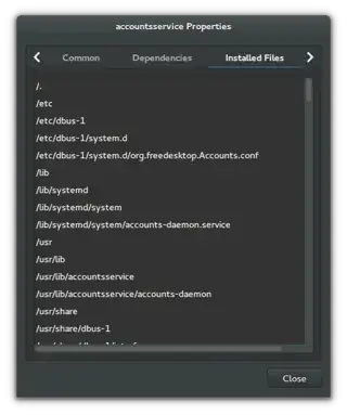

Using the GUI
For this you need to install a package manager. Synaptic is the best that it comes to mind, so, lets use it (there's also packagekit, but it requires to install many dependencies). So, first install Synaptic, search for your package, right click it, select "Properties", then find the "Installed files" tab, should show you something like this:
click to enlarge
(click to enlarge)
