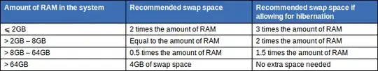

Here also a table from the Fedora 64bit docs:
For <2GB, it recommends  the swap should be '3 times the amount of RAM' in size.
This mainly depends if you need want to hibernate or not - you need more as it saves the state of the system from the RAM to the swap.
