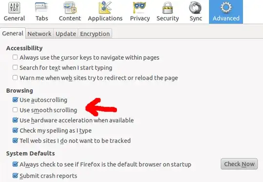

I'm wondering if you are talking about 'Autoscrolling' in Firefox here? I don't know how to get the feature system-wide, but if you are looking to enable middle click scrolling in Firefox, go to Edit/Preferences/Advanced/General and click Use autoscrolling. (Note that if you middle-click while hovering on a link, you will open that link in a new tab).
If this is what you want, you should update the question to mention Firefox. If not, sorry I couldn't help. enable autoscrolling
