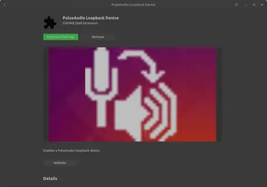

Bit late but for those who still need help:
Install the 'PulseAudio Loopback Device' GNOME Shell Extension (just search the bit in quotes in Ubuntu Software).
PA Loopback Device Extension Screenshot
It has hardly any noticable latency and was a perfect solution for me after quite a bit of searching! Hope this is useful to somebody!
