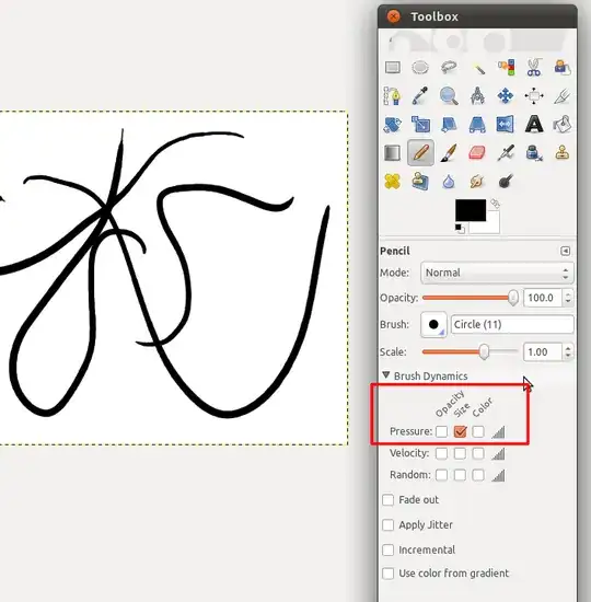

Make sure you have checked Pressure: Size in the Brush Dynamics section of the Toolbox:
If this still doesn't work, you probably haven't enabled the tablet. To do so, go to:
  • Edit → Preferences
  • Input Devices → Configure Extended Input Devices
  • Choose your device and set it to Screen mode
  • Save, close, and try again.

If you do not see the items Pressure, Velocity and Random you need to open those fields by clicking on "Brush Dynamics". This will unfold the three checkbox fields as shown in the screenshot. It took me an hour to find this out.
