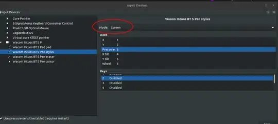

Go to Edit > Preferences > Input Devices then click Configure Extended Input Devices. You should see the different elements of your tablet listed. From there you can click on the pen element of your Intuos, and you'll see a drop-down menu next to Mode. Change the mode from Disabled to Screen. You can edit the Pressure Curve here to change sensitivity settings. I also tried enabling the Pad element (from Disabled to Screen) and left the pressure curve alone--I liked the results better when the pad was disabled and only the pen was enabled, but I don't know know many of the nitty gritty details about how tablets work, and you may want to play around with how these two elements interact when they're both enabled.

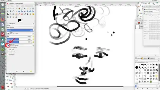

Beyond that, the tools in Gimp themselves have Dynamics options that can change the effect that input from your tablet has on what you're drawing. If you don't have a Tool Options dialog box open, open one up (I dock mine under my Toolbox). You should see a Dynamics section near the bottom. There are multiple profiles you can pick from, like Pressure Opacity, or you can add a custom one by clicking the button with the blue arrow and three red dots. This opens a drop-down menu of all existing profiles, and at the bottom of the list you'll see a plus sign button. Click that to make a new Dynamics profile. (See here for more info on Gimp/tablet use).
Dynamics dialog

i had similar trouble getting pressure sensitivity working for the "Wacom Intuos Bluetooth SM" (CTL4100WLK0) on ubuntu 19.10 with the 4.20 kernel (also did not work on 5.5 and earlier 5.x kernels). unfortunately the xsetwacom commands were successful but didn't result in pressure sensing. (however, those commands did work perfectly for ubuntu 18.04)
what worked for me was compiling the latest xf86-input-wacom driver from https://github.com/linuxwacom/xf86-input-wacom#what-is-xf86-input-wacom
i followed the build instructions for ubuntu/debian here: https://github.com/linuxwacom/xf86-input-wacom/wiki/Building-The-Driver - thankfully it was a very straightforward build just copying and pasting the instructions.
once the latest driver was built, no command line setting was required and pressure sensing worked perfectly in gimp. furthermore, it also picks up the tablet as a separate drawing device rather than acting like a copy of the mouse/touchpad (eg, you can have a different brush selection on the tablet and the mouse at the same time)
i suspect this will need to be done for the next LTS ubuntu 20.04 unless they incorporate the latest build of xf86-input-wacom in that release.

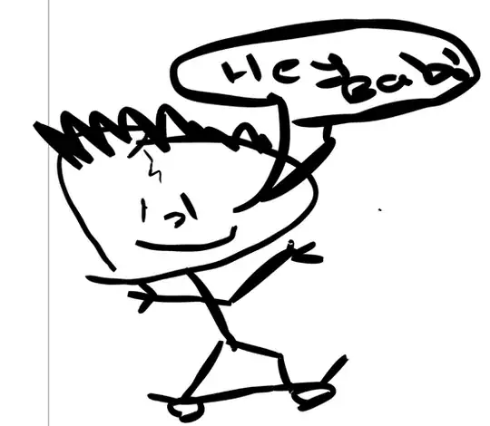

Problem
Couldn't get Wacom Intous tablet working properly in Inkscape.
Solution
  1. Inkscape > Edit > Preferences > Input Devices
  2. Select 'Wacom xxxxxxx Pen Stylus'
  3. Select Mode Screen or Window
Pressure sensitivity worked perfectly after that! Check out my first drawing:

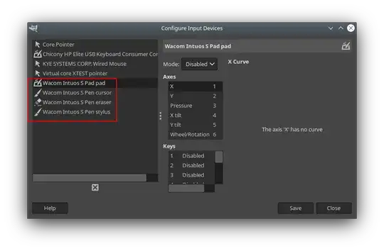

For people who want to know those 4 options of a Wacom Intuos S CTL 4100 in "Configure input devices" at GIMP.
  • Wacom Intuos S Pad pad
  • Wacon Intuos S Pen cursor
  • Wacon Intuos S Pen eraser
  • Wacon Intuos S Pen stylus
Thanks to dmitry-kulikov at github.
# "xsetwacom list" shows:
DEVICE_STYLUS='Wacom Intuos S Pen stylus'
DEVICE_PAD='Wacom Intuos S Pad pad'
DEVICE_CURSOR='Wacom Intuos S Pen cursor'
DEVICE_ERASER='Wacom Intuos S Pen eraser'
xsetwacom set "$DEVICE_STYLUS" Mode "Relative" # mouse mode xsetwacom set "$DEVICE_STYLUS" Button 1 "button +0" # nothing on touch xsetwacom set "$DEVICE_STYLUS" Button 2 "button +1" # left click on lower button xsetwacom set "$DEVICE_STYLUS" Button 3 "button +3" # right click on upper button
xsetwacom set "$DEVICE_PAD" Button 1 "key +Super_L" # "Super" key on 1st pad button xsetwacom set "$DEVICE_PAD" Button 2 "button +2" # middle click on 2nd pad button xsetwacom set "$DEVICE_PAD" Button 3 "button +9" # "forth" on 3rd pad button xsetwacom set "$DEVICE_PAD" Button 8 "button +8" # "back" on 4th pad button
xsetwacom set "$DEVICE_CURSOR" Mode "Relative" # mouse mode xsetwacom set "$DEVICE_CURSOR" CursorProximity 1 # cursor should be moved only if pen has contact with pad; unfortunately it does not work
xsetwacom set "$DEVICE_ERASER" Mode "Relative" # mouse mode
Wacom Intuos S Pad pad, refers to 4 buttons in the top of the Wacom tablet(ExpressKeys).
Wacon Intuos S Pen cursor, refers to the configuration of the proximity between the pen and the pad.
Wacom Intuos S Pen eraser, refers to the eraser option in the pen, although that is not supported in the device in question.
Wacom Intuos Pen stylus, refers to the 3 buttons in the pen, 2 buttons in the side and the tip.
