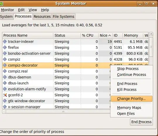

GUI
  • Alt+F2 and type sudo gnome-system-monitor
Prior to 11.04: System > Administration > System Monitor. Choose Processes.
In 11.04: Alt+A and search for system monitor.
The id's are shown in the image here:
And nice does not require sudo for increasing niceness if you own the task. It does if you need to decrease niceness.

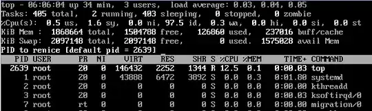

You can also renice a process within top.
  1. Start top
    $ top
  2. Renice by pressing r. You will be prompted for the Process ID (PID) of the process you wish to renice. The default PID is the first process (one consuming the most resources). Confirm with Enter. Set the new nice value from -20 (higher priority) to +19 (lower priority).
    screenshot

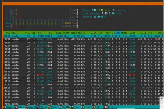

htop
  1. Start htop
  2. Renice with F7/F8 (if you are inside Byobu temporary disable shortcuts with Shift + F12). Keep in mind you need root privileges to reduce niceness.
screenhot
