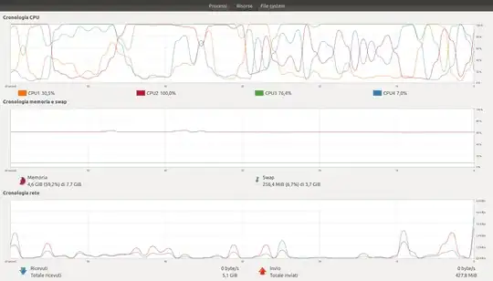

By this, I found that, if I ask top, the program I am running shows a CPU usage of 100%, while when I open the System monitor the CPU usage is only at ~25% in the Processes tab. In addition, the Resources tab in System monitor shows 4 CPUs, whose usage changes from ~5 to ~100% for each one:
CPUs usage

In short: no. The program is single threaded.
Top can show cpu use in two ways: saturation per CPU, or share of total. If you have a four core system, top may show Irix mode:
Also for multi-processor environments, if Irix mode is Off, top will operate in Solaris mode where a task's cpu usage will be divided by the total number of CPUs. You toggle Irix/Solaris modes with the `I' interactive command.
You can toggle this by pressing I in top. As you have four CPU cores, the use is divided by four, and you will show 25%. If you turn on Irix mode, it will show 100%.
Your application is single threaded. It executes a sequential thread, on one CPU core. If you have the source code, you can change this. It's usually not a trivial task however, and depending on task it may not be possible.

According to lscpu, you have four cores in your CPU:
On-line CPU(s) list:   0-3
top uses 100% per core, so if you have a four-core processor, that's 400%. You're using one core up completely, so that's 100% out of the 400%. The system monitor uses 100% for everything (or perhaps per actual CPU, I'm not sure). One core is a quarter of the four cores available, so it shows up as 25% usage in the system monitor.
