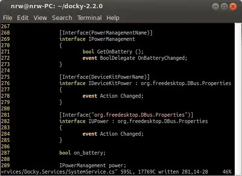

I needed a more step-by-step answer, and found this guide: http://www.tdrusk.com/wp-content/plugins/really-static/static/2015/01/24/how-to-fix-docky-crashes-when-suspended-or-unplug-in-ubuntu-14-04-and-14-10/
Basically, applies the fix mentioned by Jamie above using the "classic" instructions here How to download, modify, build and install a Debian source package? to fix, build, and install from source (easier than it sounds, maybe 5 or 6 lines).
For reference, for me the single-line fix was on line 281. enter image description here
And hooray, now I don't have to restart docky all the time!
