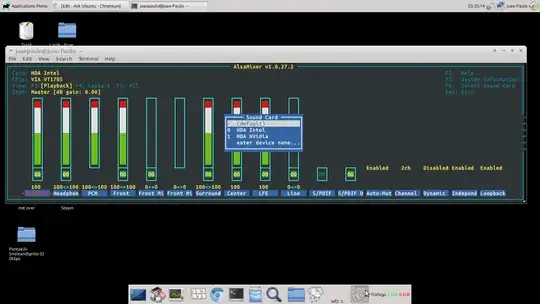

I had, initially, a Ubuntu installation running completely fine. Compiz bugged, then I switched to LXQT.
LXQt bugged between sessions, then I switched to KDE. KDE bugged on some applications, then I switched to XFCE (at the moment).
Sound worked fine between all those transitions up until now. When I finally installed and rebooted my PC, sound was gone.
I'm running Ubuntu 14.04 x64 on the XFCE Enviroment. Switching to another session/enviroment doesn't work.
What I've done already:
  • Reinstall alsa and pulseaudio (purging)
  • Add a string line at the end of alsa.conf

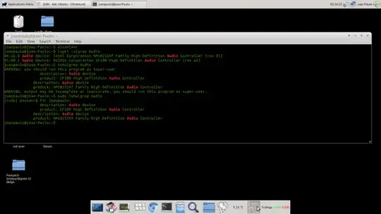

  • Check if my audio drivers are being detected

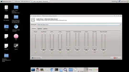

  • Try unmuting sound values on the xfce4-mixer
  • Purging pulseaudio and trying to work with only alsa
  • General information I found on the similar topics didn't work either
  • Tweaking values on alsamixer
Any help would be appreciated. As I said, problem started when I installed Xubuntu.
I was told to remove xfce4-mixer but I had to uninstall the xfce4 package along it, should I proceed?
EDIT: Some SSes and pastebin/ryUuDpEr, pastebin/e6KLYf5D
Some screenshots: enter image description here enter image description here enter image description here

OP HERE
Aswering because I've been able to narrow down my problem.
It seems like Xubuntu comes with Pulseaudio by default. It seems like Pulseaudio overrode my ALSA native settings, becoming the main output device. The problem here is that PulseAudio won't detect my onboard audio chip, only the GPU one that I won't use.
If I try to uninstall Pulseaudio, however, ALSA won't naturally take his place. I tried to open a music on VLC to test after uninstallid pulse and it said "No default output device ...".
So I need to do either:
  1. Force PA to recognize my onboard card
  2. Uninstall PA and make it my default device for outputting sound
I can't play a sound with aplay, by the way.
https://i.sstatic.net/oCinI.png
EDIT: Solved using this link http://ubuntuforums.org/showthread.php?t=2186531
