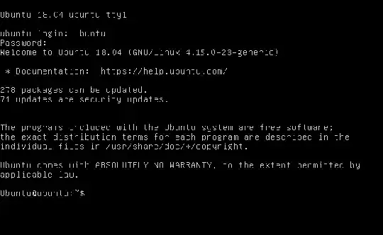

Early user terminals connected to computers were electromechanical teleprinters or teletypewriters (TeleTYpewriter, TTY), and since then TTY has continued to be used as the name for the text-only console although now this text-only console is a virtual console not a physical console.
There are 6 virtual consoles in Ubuntu accessed by the keyboard shortcuts Ctrl+Alt+F1 to Ctrl+Alt+F6. You can move away from a virtual console (move the console to the background) by using the keyboard shortcut Ctrl+Alt+F7.
In Ubuntu 17.10 the login screen now uses virtual terminal 1. In Ubuntu 17.10 and later press Ctrl+Alt+F3 up to Ctrl+Alt+F6 for accessing a virtual console and press Ctrl+Alt+F2 to go back to the desktop environment.
enter image description here Ubuntu 18.04 virtual console
