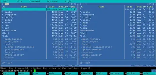

Alternatively you could try to install Midnight Commander (I hope there is a little free space left) that will display the file system in a more familiar way:
sudo apt install mc
Then run it by the command mc. The key F8 is the Delete key, but be careful! F5 is for Copy. Use Tab ↹ to switch between the left and the right side. F10 is for Quit. For more commands see the bottom line of the image below or press F1 for Help.
