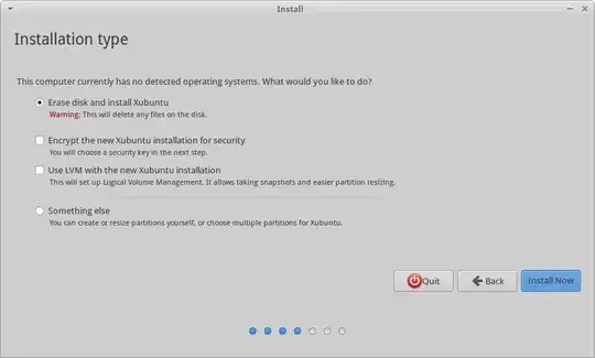

The problem is, the live CD installer doesn't acknowledge the existence of the Windows install and also does not display the 50Gb partition I left for the Xubuntu install.
No option for installing alongside Windows

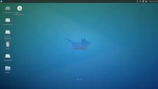

When I run in live CD mode (actually from a USB pen), it auto mounts the storage partition, the Windows partition and the boot partition (I'm guessing created by Windows).
See the mounted partitions

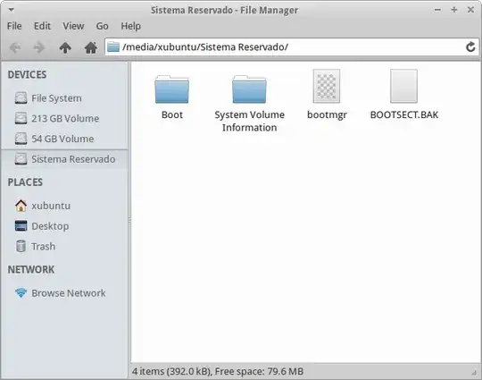

I have been reading around about this and I know the Windows session was terminated correctly (ie, shut down). Also, the "Sistema reservado" (system reserved - I'm portuguese) partition in the image above shows the following:
System reserved partition contents

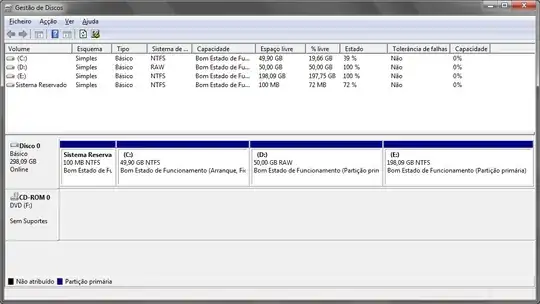

As requested, here's the Windows Disk Management screenshot:
Disk Management in Windows
