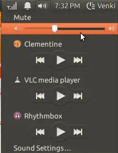

I know that this has already been asked a lot, but all solutions that I found are old, pre - Unity. So, I am asking again: How can I decrease the sound increment(or decrement) that happens when the mouse wheel is scrolled, if the cursor is hovering over the volume bar(like shown below)?
You should control your volume either my mouse scroll as you suggested or by left/right arrow keys.
If arrow keys aren't working, then it's probably a bug described at indicator-sound keyboard controls with left/right ARROW keys broken.
This bug was fixed in the package ido - 13.10.0+14.04.20140213-0ubuntu1.
If the volume adjust is too coarse-grained, try upgrading indicator-sound package (>= 0.5.6) or try to Decrease mouse sensitivity below the standard limit.
Alternatively you can define your own keyboard shortcuts in System->Preferences->Keyboard Shortcuts. As a side note you must have the correct sound mixer device selected in System->Preferences->Sound for it to work properly. This may be a problem source if your volume will not adjust.
