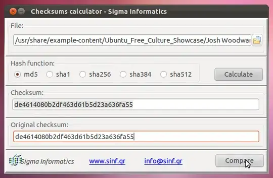

If you want a GUI, as this suggests, you can use this:
or other similar Ubuntu packages like GtkHash (sudo apt install gtkhash)

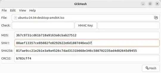

GtkHash
Click the icon of the folder at the end of the File: field, press Enter, and click the Hash button to display the checksum hashes. The Ubuntu 24.04 .iso file has a separate SHA256 checksum file used for checking it called SHA256SUMS. The downloaded .iso file is verified if the SHA256 checksum in GtkHash matches exactly to the SHA256 checksum in SHA256SUMS.
