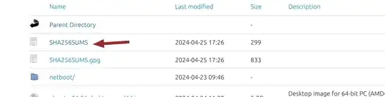

Go to the releases page https://releases.ubuntu.com/
Below is 24.04 https://releases.ubuntu.com/noble/
Click on the Sha256Sums link and right click and "save as" SHA256SUMS.txt (it will choose the name automatically) Make sure the iso and the checksum are in the same directory.

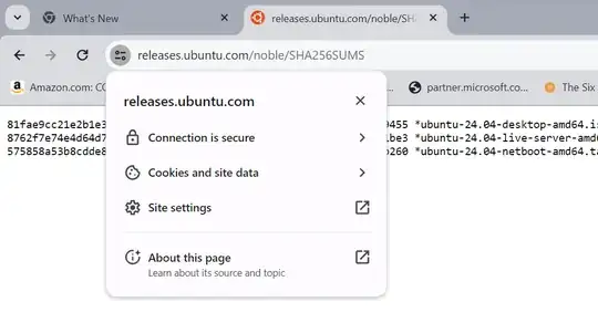

Someone asked.. "What is the use if the sha256 is not valid?" I think the ancient old instructions were before https was enforced with all browsers. Here is a screenshot below: enter image description here

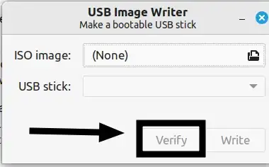

You can also use the usb image writer's verification by pasting url USB Image Writer (from mint)
