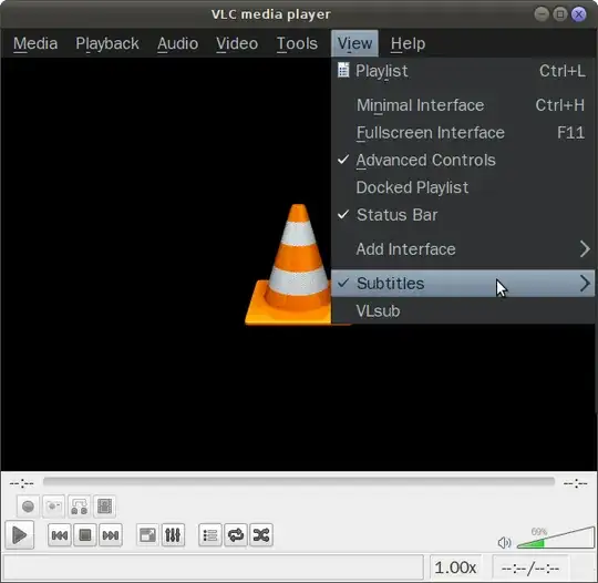

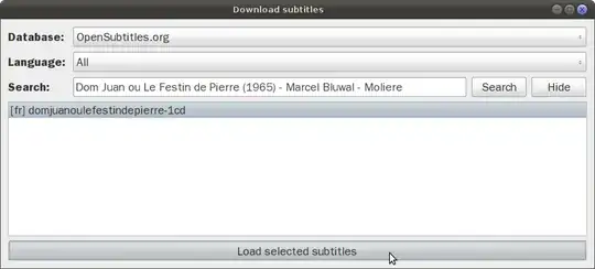

I found a VLC script called 'Subtitle finder' (here) that downloads and displays video subtitles 'on-the-fly': they are downloaded and displayed during playback, and it works great, but does not saves subtitle file for the future: the whole procedure has to be restarted each time. (See this answer.)
While the script says ‘Download subtitles’, I imagine they are downloaded and saved temporarily during playback: where are they downloaded? can I manually save them for future use?
