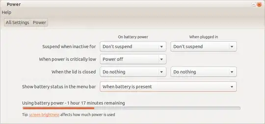

I've looked in the power settings to make sure it's set to show no matter what:
power settings
I assume "When battery is present" means "show the battery indicator whether charging or plugged in or whatever, just as long as the physical battery is in the laptop." I also tried the other option, "When battery is charging or in use", but that doesn:t make a difference.

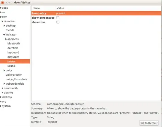

sudo apt-get install indicator-applet-complete
sudo apt-get install dconf-editor
change icon-policy to present. This might help you.
