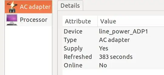

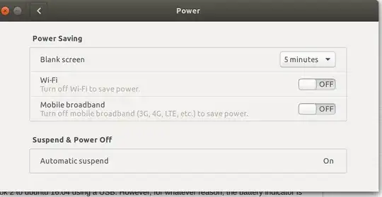

I have tried some of the other solutions on this site, but none of them have worked for me. Here's a few other screenshots that might help (I have my power adapter connected during these screenshots):
(Settings > Power) enter image description here

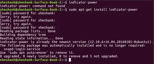

EDIT: From one of the answers below, please see my terminal output. It says the command doesn't exist, but also that indicator-power is installed.
enter image description here enter image description here enter image description here
I'd make sure the power indicator is installed first:
indicator-power
And if it isn't, then I'd install it:
sudo apt-get install indicator-power

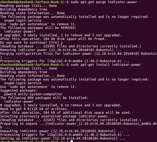

If it is installed, then it might have just crashed. I'd try restarting it:
/usr/lib/x86_64-linux-gnu/indicator-power/indicator-power-service &disown
And if that's still not working, then I'd reinstall it:
sudo apt-get purge indicator-power

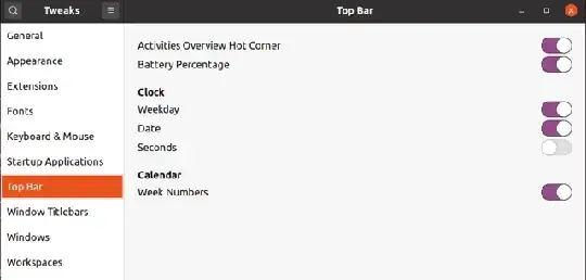

One solution I’ve seen work with a couple of different Surface models is to use Gnome Tweaks:
  1. sudo apt install gnome-tweaks
  2. sudo ln -s /usr/lib/x86_64-linux-gnu/libusbmuxd.so.6.0.0 /usr/lib/x86_64-linux-gnu/libusbmuxd.so.4
  3. sudo systemctl restart upower
From here, you can open the gnome-tweaks application, choose "top bar", then toggle battery percentage.
Hope this helps.

  1. Try installing gnome-tweaks
    sudo apt-get install gnome-tweaks
    gnome-tweaks &
    and activating the Battery percentage. You reported an error, but it is not clear at which point you got it.

i had problem with ubuntu 20.04.02
$ sudo systemctl restart upower
Job for upower.service failed because a fatal signal was delivered to the control process. See "systemctl status upower.service" and "journalctl -xe" for details.
checking with
 $ systemctl --failed
UNIT LOAD ACTIVE SUB DESCRIPTION
● upower.service loaded failed failed Daemon for power management
so i had to install
$ sudo apt install systemd:amd64 systemd-timesyncd:amd64
and now service started and battery indicator is back
$ sudo systemctl start upower
