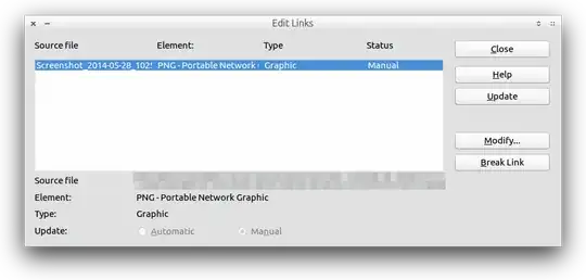

Linking an image in LibreOffice Impress
You can do this by linking the images instead of inserting them.
Go to InsertPictureFrom file.... Select your file and check Link in the file selection dialog that comes up:
Confirm your choice with OK. A new dialog should spawn that will ask you to confirm linking the image instead of inserting it. Click on OK again.
From now on any changes to the image will automatically show up when reloading the document. You can also update your links through the Link Editor (EditLinks...):
For more information on linking/inserting images check out the link Korkel posted.
As an aside: If you are interested in linking images by default you should give this Q&A a look. Note: The CTRL + SHIFT workaround posted there doesn't appear to be working in LO Impress.
