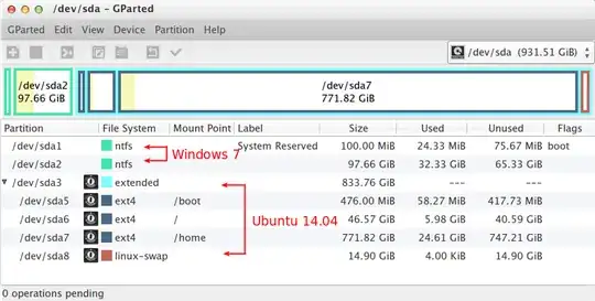

If you have enough time see also this tutorial: Dual Boot Windows 7 and Ubuntu 12.04. I used this tutorial to install Ubuntu 14.04 alongside Windows 7 and it worked :)
However my partion table look a bit different. If it'll help you I put the screenshot of it below:
