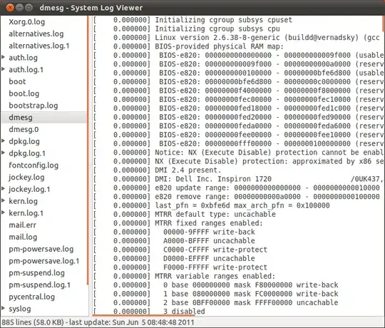

use this tool to simplify your life
log file viewer is a good place to start:
im1
set up log notification this way and when somethings wired happened, start here
It is a bit hard to answer this but I always start with dmesg or with the log related to the problem (no need to look in .xsession-errors when you get an error during booting ;) )
