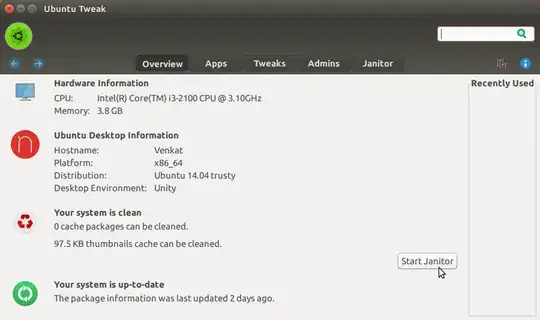

But I am guessing that this might have something to do with system cache. You might try clearing it off with Ubuntu Tweak's 'Janitor' feature. Install Ubuntu tweak with these commands:
sudo add-apt-repository ppa:tualatrix/ppa
sudo apt-get update
sudo apt-get install ubuntu-tweak
Then open it from dash or with the terminal command:
ubuntu-tweak
It will show up like this and you need to select Start Janitor(as seen below):
enter image description here (I am using numix circle icon theme and so it may look different for you according to your theme)
Now in the Janitor select whichever kind of cache you want to remove and then select Clean. This should remove unwanted cache from your computer. Now see if your problem persists.
