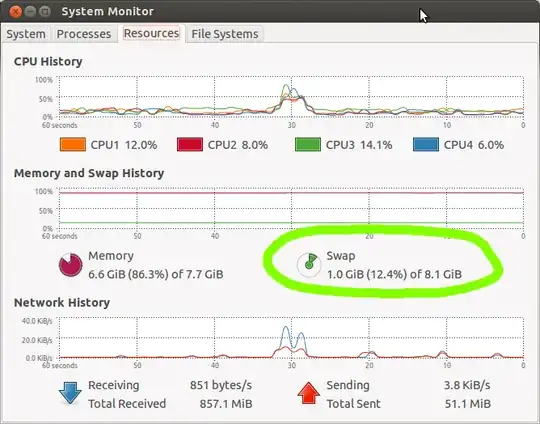

I was having the same issue, Eliah Kagan's answer on this other thread did the trick for me.
Here's the most important bit:
  1. Open a Terminal window (Ctrl+Alt+T) or a virtual console and run: sudo swapoff -a
  2. Open /etc/crypttab (e.g., sudo nano -w /etc/crypttab or sudo -H gedit /etc/cryptab for a GUI editor) and put a # at the beginning of the line that starts with cryptswap1. Save the file.
  3. Do the same thing with the line that starts with /dev/mapper/cryptswap1 in /etc/fstab.
  4. Install gparted Install gparted. Run it and format your swap partition as linux-swap. Make sure to get the right partition; if you get the wrong one, you'll lose possibly important data! The line you commented out in crypttab should give the correct partition name (it comes right after /dev/).
  5. Run sudo mkswap /dev/..., repacing ... with that same device name. Part of that command's output should be text that says UUID=..... where ..... is a string of letters and numbers.
  6. In the file /etc/initramfs-tools/conf.d/resume, find the line that says RESUME=UUID= followed by letters and numbers like (but not identical to) ..... from the last step. Replace them with ..... (i.e., with the letters and numbers mkswap gave after UUID=.
  7. Run sudo swapon /dev/... (with the same /dev/... as you had in steps 4 and 5 above).
  8. Run sudo ecryptfs-setup-swap.
swapon -s will check to see if swap is successfully enabled. See that blog post for more information, and example output, for checking this.
No more laggy behavior ð‿ð enter image description here hey look, imgur gave the image a palindromic name
