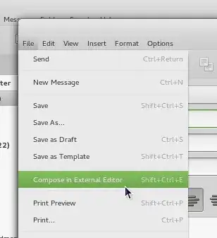

Once set up, you simply need to open the compose window, and then open it in the external editor: look under 'File' for 'Edit in external editor'

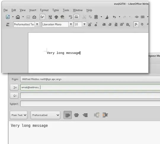

You can then edit the message in Libreoffice, and when you save it and exit the message will be in Evolution: enter image description here
The only real problem with this is as it seems to use a text/plain format, no formatting is saved from Libreoffice.

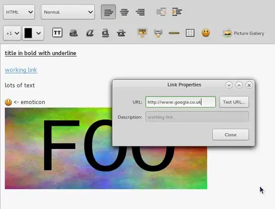

Also, if just want a format when you can use links and formatting, set the type to HTML: This can include formatting, embedded images, emoticons :D , and also has a thing that can be used to create and test links.

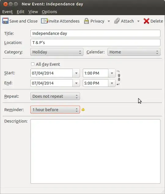

Here's an image of an event being added. You can see that it's fully featured
addevent

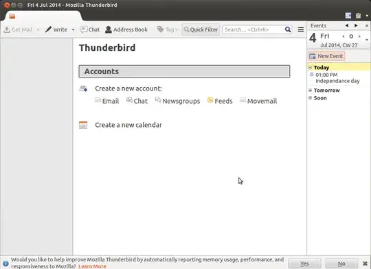

It fully integrates with thunderbird. Here's an image without my email setup to give you an idea. You can see the scheduling in the right hand column. If I still had my email account setup it would show this list in the body of the main screen.
integrated
