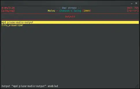

  1. If pulse doesn't work for you, you can always try alsa settings. Simply reverse/change # comments.
  2. In ncmpcpp use either [8 and/or F8: Outputs], to activate/deactivate audio-output, by highlighting it, followed by pressing Enterkey!
