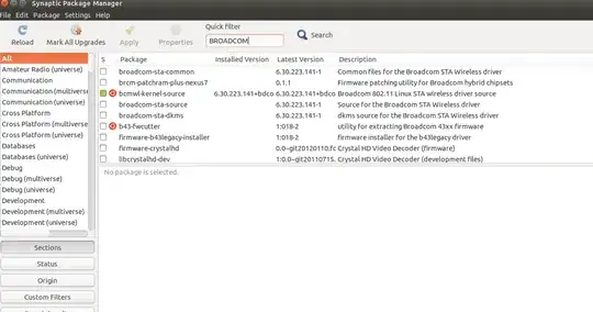

I installed as given in the screenshot below.Use synaptic and type broadcom in search box Do not use jockey-gtk, it will fail to load there.
Install it in this way,
Reboot and your problem will be resolved. I was using 12.04 earlier and these proprietary drivers were not working there. But in 14.04 they are working flawlessly. If failed, try to install again as per broadcom documentation.

From the GUI:
Package Manager (System>Administration>Synaptic Package Manager). Click the Reload button in the upper left corner of Synaptic to refresh your index then search for and reinstall the package named bcmwl-kernel-source.
From the shell: sudo apt-get update sudo apt-get --reinstall install bcmwl-kernel-source
