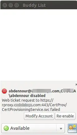

I get this message :
Web ticket request to https://rproxy.mycompany.com:443/CertProv/CertProvisioningService.svc failed

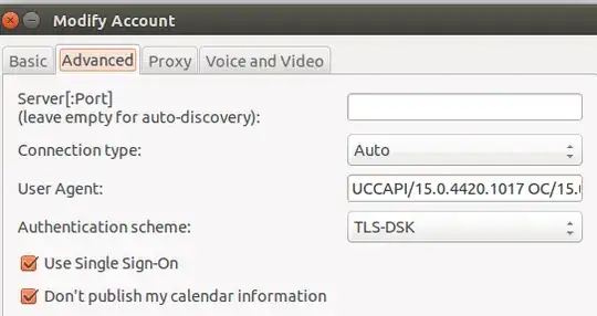

Known that settings has been configured as following: enter image description here

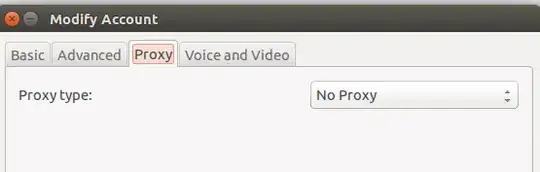

And No proxy: enter image description here

And Why rproxy appeared in message error even there is no proxy in my settings .
I mean :

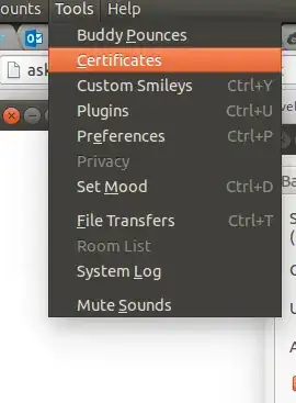

UPDATE :
I found where can i import certificate :

Known that Authentication Scheme is: Kerberos , not TLS-DSK

  1. The proxy in the name isn't a proxy on your PC, it is a reverse proxy which seemed to be used in the lync implementation on your side
  2. Pidgin on Lync 2013 works fine with TLS-DSK enabled
  3. Make sure that you use the correct user agent, Lync has a policy which can block clients which aren't in a list configured by the admin
