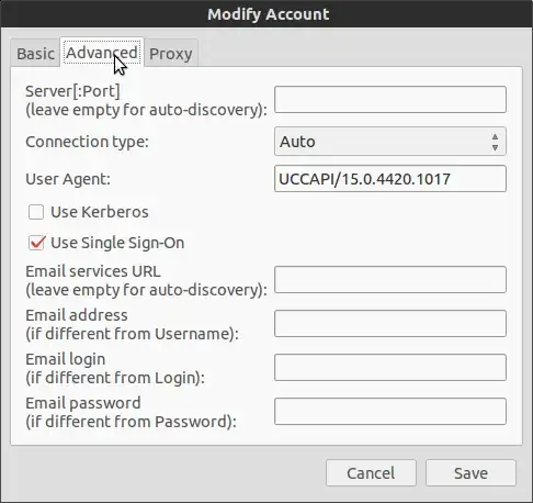

Below are some images of my settings (I have changed the company name to "company" for annonymity.

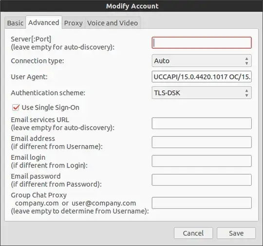

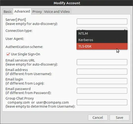

It appears that the pidgin/sipe setup I have installed here has a third authentication type for TLS as seen in this picture which is what I needed. enter image description here
For reference, here are my connection settings that are working: enter image description here enter image description here
The other tabs are the defaults
