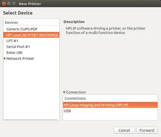

1. Open printer setting. It detects my Hp Laser Jet P1007
detect

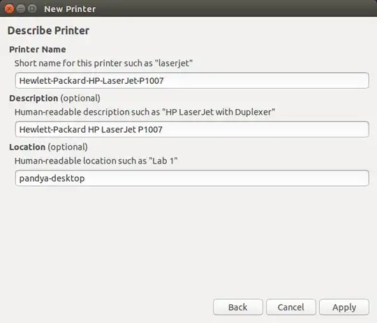

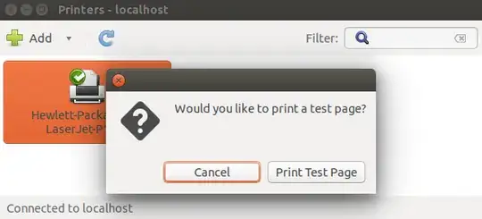

2. It Auto configured correctly and ask to print test page
Describedtest-page

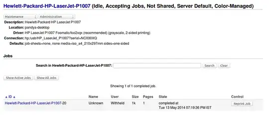

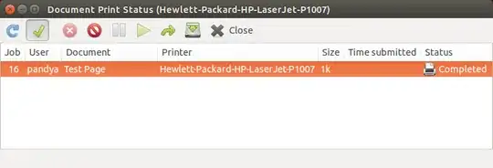

3. But It not prints test-page. Also not-printing anything and says job completed!
queue
Though It detected & configured properly but not printing.
Details from local-host:localhost
