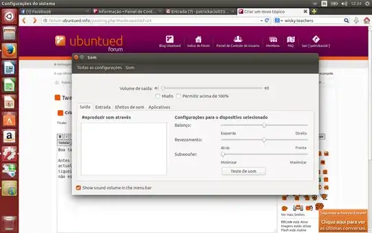

Before I was using Windows 8 on my notebok and ubuntu on the desktop. I decided to test the update 14.04 in the notebook, installed and worked perfectly, when one day I called and the sound wasn't working anymore, I went to look at the audio configuration and saw that he wasn't recognizing the audio card. Can someone help me?
$ aplay: device_list:268: No sound card found...
