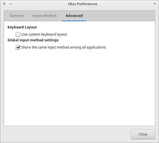

There appears to be two ways to set the keboard layout in XUbuntu. I'm used to Linux Mint Cinnamon and tried setting the layout through the usual Keyboard settings. However, just reading this thread made me realise that right-clicking on the keyboard indicator and choosing Properties gave me the opportunity to add the keyboard layouts that I wanted (again) and now they are working as required although I haven't tried toggling between them yet.
  1. Right-click on the indicator and click preferences.
  2. Select the advanced tab.
  3. Unselect "Use system keyboard layout".
Screenshot
