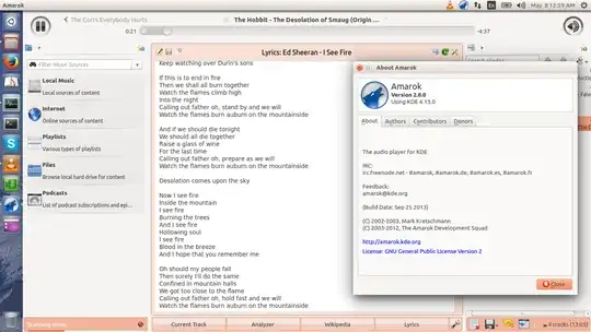

I have installed Amarok in ubuntu 14.04 LTS 64 bit. It can fetch lyric for music just fine. I know this is not the perfect solution, but until they fix the problem with banshee-extension-lyrics I am using Amarok as alternative. enter image description here
