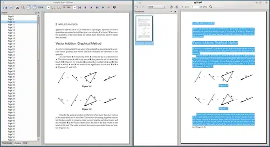

Here is one way, which would require some not so common tools:
  1. ocrodjvu
  2. pdfbeads, that has it's own requirements which can be found by Google
We can use djvu2hocr command (from ocrodjvu package) to extract hidden text layer from DjVu file (it doesn't do any OCR or similar, it just extracts text layer with geometry), i.e.:
djvu2hocr -p 10 sample.djvu | sed 's/ocrx/ocr/g' > pg10.html
sed intervention corrects class names in output hOCR (which is just simple HTML file)
Now we extract DjVu page to TIFF format with:
ddjvu -format=tiff -page=10 sample.djvu pg10.tif
so that we end with these file in out work folder:
sample.djvu
pg10.html
pg10.tif
This is where pdfbeads comes in play, and we simple execute:
pdfbeads -o pg10.pdf
then this nifty program takes care of everything that's inside this folder (HTML and TIFF files with same base name) and produces output PDF file with some by-products:
sample.djvu
pg10.html
pg10.tif
pg10.jbig2
pg10.pdf
pg10.sym
which is identical to input DjVu file and has text layer inside:
