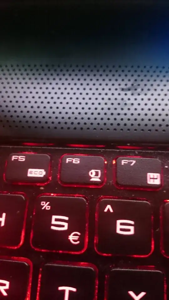

37
I finally figured this out. For the longest time, I just thought the web camera in my laptop was broken. It didn't even show up when doing an lsusb ...and it won't, because hitting the web camera function key on the laptop adds/removes the device in hardware as if it has been physically connected/disconnected.
You must hit Fn+<Camera Key> on your keyboard and then you'll see the following in your kernel logs:
[22219.057985] msi_wmi: Unknown event received [22219.509572] usb 3-1.4: new high-speed USB device number 6 using ehci-pci [22219.646222] usb 3-1.4: New USB device found, idVendor=5986, idProduct=055c [22219.646229] usb 3-1.4: New USB device strings: Mfr=3, Product=1, SerialNumber=2 [22219.646233] usb 3-1.4: Product: BisonCam, NB Pro [22219.646237] usb 3-1.4: Manufacturer: Generic [22219.646239] usb 3-1.4: SerialNumber: 200901010001 [22219.649336] uvcvideo: Found UVC 1.00 device BisonCam, NB Pro (5986:055c) [22219.652486] input: BisonCam, NB Pro as /devices/pci0000:00/0000:00:1a.0/usb3/3-1/3-1.4/3-1.4:1.0/input/input19
Here is what the key looks like on my MSI WS-60. It varies from laptop to laptop. Hit it and you should watch /dev/video0 appear and disappear.

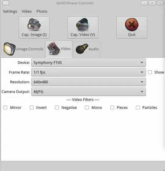

You can try GTK UVC video viewer . This software is available in software center. Then go to Videos and select the device. I have two device connected with my computer. I keep my mobile device active, because of that in device it is showing Symphony FT45. In your case chose the default device. This might solve your problem. Have fun.
enter image description here.

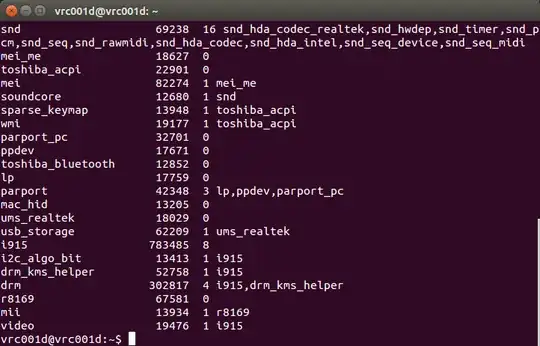

I had a similar problem - it will probably be solved when you update and upgrade your computer.
try this command:
lsmod
In this screen you'll find the devicename, its number, the third column means that your device activated or not (0 means not activated). See screenshot below:
To activate this device use this command :
modprobe <name of the device>
your kernel will run the activate automatically after rebooting.
You can also do it manually through this file /etc/rc.d/rc.modules
