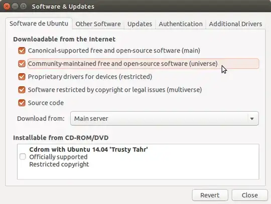

Do you have your universe repos enabled?
I'm using Ubuntu 14.04 and I can see it:
$ apt-cache show digikam | grep Filename
Filename: pool/universe/d/digikam/digikam_3.5.0-0ubuntu10_amd64.deb
Try enabling the Universe repositories:
$ software-properties-gtk
Then leave the "universe" repositories option checked
Click "Close" and allow the packages info to be updated.
