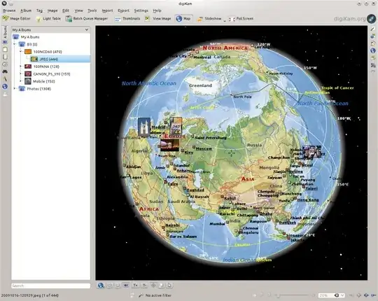

Digikam is by far the best photo-management utility on Linux, and it does support showing a map with your photos on it.
See this related page for instructions on installing Digikam on Ubuntu 14.04.
