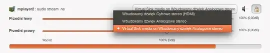

Install pavucontrol and run it. You should see all applications connected to PulseAudio server. Make sure application you want to stream (eg. Spotify) is playing something and is visible in Playback tab. enter image description here
Change it's output to virtual sink you've created. Now click Recording tab and to the same for application that is used to do streaming (eg. TeamSpeak).
TeamSpeak should hear Spotify now :D
