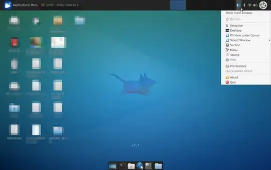

When I log into an Xubuntu session, the panel has a ton of junk from the Unity interface (a Power menu with a non-working logout button, an extra language indicator that does not work, an extra clock).
extra junk in the panel

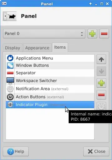

  1. Right click on the panel → panel → Panel Preferences... → Items tab
    Then select Indicator Plugin
  2. Either you remove it completely from panel using (-) button, or as I recommend customizing it.

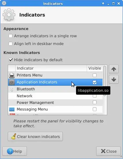

    • Click (gear) button
    • Check "Hide indicators by default"
    • Check "Application Indicators" to be "Visible"
    Why? because some application uses only libappindicator method to show their status icon. You may not want to miss them.
