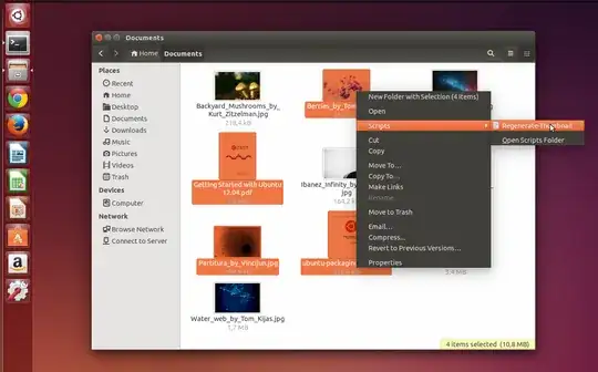

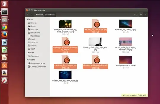

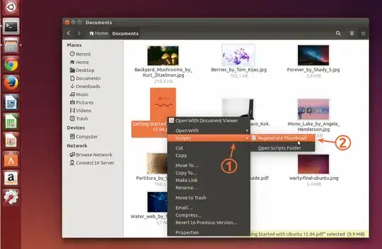

4) To test the script you can open nautilus, select a file(s), right click and go to Scripts > Regenerate-Thumbnail.
