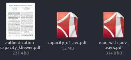

I deleted my ~/.cache/thumbnail folder but some of the PDFs' icons are still not properly displayed. They are still displayed using the default PDF icon. I am attaching a screenshot of the icons. I don't understand why some (the first one) are being displayed correctly (ie, customised icon based on the content) while others have default icon.
The other PDFs are NOT of bad quality print where it looks like it is a scanned copy of a document. Not quite sure what's up with nautilus here.
It seems like nautilus cannot generate thumbnails for pdf if evince is not installed or is installed as a flatpak. https://gitlab.gnome.org/GNOME/nautilus/-/issues/13
Had the same problem. Reinstalled evince and all is good.
sudo apt-get install evince

It's important to quit or kill nautilus after the deleting the thumbnails:
nautilus -q
killall nautilus
Check failed thumbnail creation
The path for failed thumbnails (ubuntu 14.04 LTS or later) is ~/.cache/thumbnails/fail. So just check the folder and delete them:
rm -r ~/.cache/thumbnails/fail
Force thumbnail recreation
Try changing its modification timestamp, e.g. via:
touch -m YourFile.pdf
See How to regenerate a specific thumbnail in Nautilus?
Thumbnail recreation mechanism
According to the freedesktop documentation Thumbnail Managing Standard . You can force nautilus to recreate the thumbnail if the mtime (modification time) in the thumbnail is lower than the mtime in the original file.
Thumbnail size restriction
If an thumbnail image is larger than 10 MB, no preview will be displayed, but only the default file icon. To fix this behaviour you can increase this limit (doubling for example):
dconf write /org/gnome/nautilus/preferences/thumbnail-limit
Thumbnailer
You can try to create a thumbnail manually to see if a PDF can be properly converted to a thumbnail (first page [0] only):
