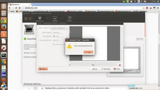

Edit6: I tried scanlite, here's the error it gives me:
Edit7: The second time I ran Scanlite, it says it dod not detect scanners on my computer. I sometimes get simillar message on simple scan.

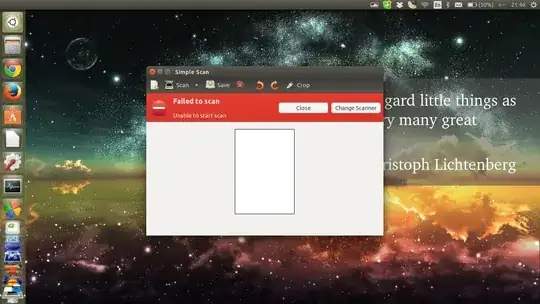

Edit8: The scanner works with simple scan after doing the following:
  1. Open System settings
  2. Clicking Printers
  3. Right click on my printer(scx-4200) -> Properties
  4. Ink/toner levels
  5. Clicking Refresh
  6. Opening simple scan
  7. Clicking scan
  8. Waiting about 10-20 seconds till the error message shows up(like on screenshot provided)
  9. Clicking scan again
And that's for 1 scan only.

Edit13: By analising errors in /var/log/kern.log, i have found out that this error line is outputed into kern.log when I get error no scanner found:
May  6 20:45:34 dusan-K55A kernel: [  500.209280] usb 3-3: usbfs: interface 1 claimed by usblp while 'scan-thread' sets config #1
And I get this error when "Failed to scan" error heppens(like in screenshot):
May  6 20:52:03 dusan-K55A kernel: [  889.843120] usb 3-3: usbfs: interface 1 claimed by usblp while 'scan-thread' sets config #1
