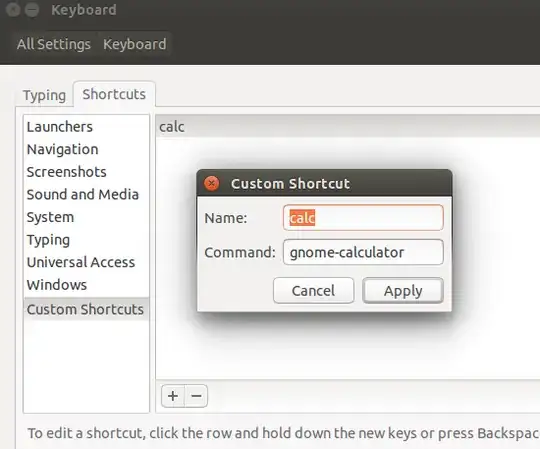

What you have discovered seems to be a bug related to some applications launched from (unity)*-settings-daemon. The bug is reported here.
However, it exist multiple easy workarounds to this annoying issue;
The one I will suggest, is to define your own keyboard shortcut, and reassign the calculator button.
keyboard shortcut
Another solution is to:
Use eg. CompizConfig Setting Manager and set the Focus Prevention Level option to off. The option is found under General Options on the tab named Focus & Raise Behaviour.
